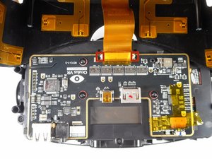

+[title] Disconnect Ribbon Cable
+[* red] Gently pull out the small side tabs on the ribbon cable connector as shown to release the cable. Push the tabs away from you, with the headset oriented as pictured. Carefully slide the ribbon cable out. The headset should now be two separate pieces.
