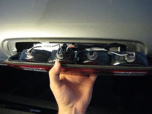

+[* black] Pull out the truck high mount brake/tail light housing.
+[* black] We recommend you pull out the housing with both hands so you don't break the water tight seal.
+[* black] If in the event that you happen you break it, you may have some water leak issues so you would have to fix the high mount brake/tail lamp housing with some glue.
