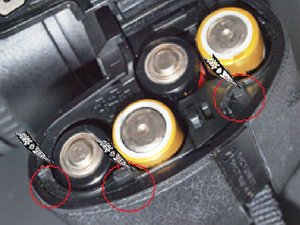

+[* black] Remove batteries, you could even use some tape to keep the battery door out of your way and prevent it from flopping down while you work.
+[* black] The three spots circled in red are the latches that seem to fail over time. You'll want to take a knife and cut of the plastic left by the broken pieces so it's flat.
