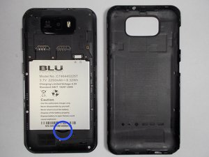

+[* blue] Place your finger in the small groove beneath the battery.
+[* black] Push the battery toward the top of the phone and lift it out.
