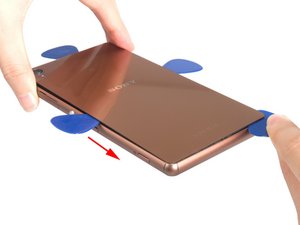

+[* black] Insert the guitar pick into the opening gap.
+[* black] Slide the guitar pick to cut the adhesive sticker. Attention: when deal with the left side, the guitar pick would better go as the direction of the mark.
