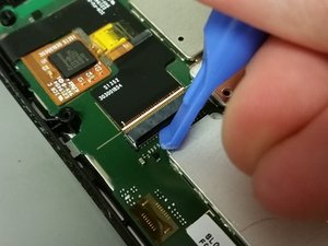

+[* black] To remove the LCD/Digitizer connection from its socket, remove the blue silicone cover
+[* black] Next, use a plastic spudger to open the socket-lock

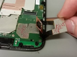

+[* black] Carefully remove the flex cable.
+[* icon_note] Altho this flex seems to exist in 2 parts, it's actually removable as one. Only the wide flex has to be disconnected.
