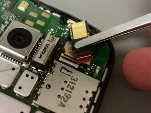

+[* black] To remove the camera, use a pair of tweezers to remove the tape

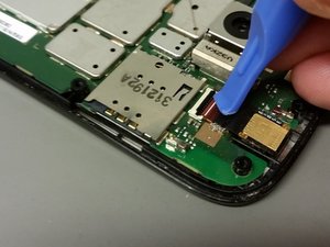

+[* black] Next, use a plastic spudger to open up the socket.
+[* black] Pull the camera up (out of the lens-socket) and pull so the flex will come out of it's socket
