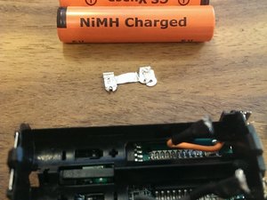

+[title] Remove Battery
+[* black] Using needle nose pliers, pry off the wires and metal tabs carefully
+[* icon_caution] Be careful to retain and not damage the metal tabs!
