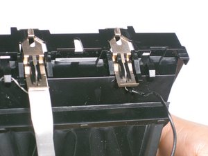

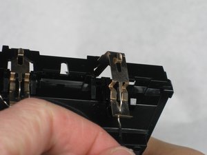

+[* black] Follow the black wire from flash bulb to the back of the case.
+[* black] When you find the brass tab, pull it up. When the tab is free, remove the tab from the black wire.
