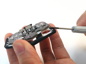

+[title] Touch panel PCB
+[* red] Remove the rubber strips on the side with a flat-head screwdriver.
+[* black] Lift up the plastic casing with a flat-head screwdriver.
+ [* black] The plastic casing ensures the LED lights are shielded to prevent bleeding of light.
+[* orange] The LED lights on the touch panel are covered with rubber light guides.
+ [* black] Light guides allow the individual LEDs to light up one by one on the touch panel. Neat.
