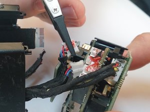

+[title] Detaching PCB stack
+[* black] There are a total of four PCBs neatly stacked up to fit in the small AXX 200 chamber. It minimizes space. Saved space = bigger audio chamber = better audio.
+[* red] To take out the stack of PCBs, first, disconnect the flex connector with tweezers.
+[* red] After that, disconnect the two connectors. These are probably connected to the microphones at the top.
+[* red] Lastly, disconnect the final connector that is linked to the battery from the bottom PCB.
