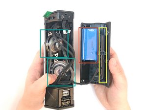

+ | [title] Opening the chamber |
+ | [* red] Remove the audio chamber by unscrewing the 6 screws with a Phillips #2 screwdriver. |
+ | [* icon_caution] Warning: lift up the delicate NFC sensor with tweezers before opening the chamber. You will have to peel off any excess adhesive to reveal the screw holes. |
+ | [* red] It’s a sizeable audio chamber for such a small speaker. Upon opening it up, you will easily identify: |
+ | [* orange] The friggin’ big battery |
+ | [* yellow] Port tube for boosted bass |
+ | [* green] Drivers x 2 |
+ | [* red] You’ll also notice that all the cables (and there are a lot of them) are shielded with foam to prevent rattling. |
