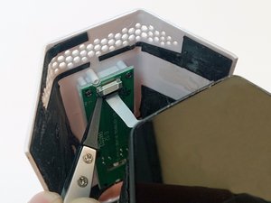

+[title] Detaching back housing
+[* red] After getting through the adhesive, lift the back casing open as pictured.
+[* icon_caution] Warning: CAREFUL! A flex connector holds the buttons on the back casing to the unit, so don’t be too eager pulling the back casing away.
+[* red] Disconnect the flex connector by simply pulling it downwards with a pair of flat-head tweezers
+[* red] Then, remove the button PCB panel with a Phillips #0 screwdriver.
