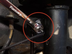

+[* black] Use the 14mm socket wrench to take off the nut.
+[* icon_note] If the sway bar link's join is spinning and the nut would not come off, then use the Allen wrench to hold down the sway bar link. See the second picture for more detail.
