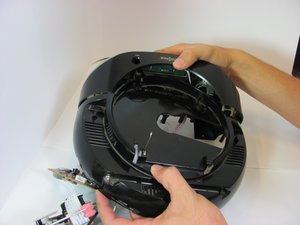

+[* black] Turn the device so the CD tray faces up.
+[* black] Use the blue plastic opening tool to separate the front half (containing the speakers and display) and the back half (containing the antenna).
+[* icon_caution] Separate the device in to two halves. Caution: when separating the device, be carful not to pull the wires out from the circuitry.
+[* black] For the next steps, you will be looking at the half of the device that contains the speakers and buttons.
