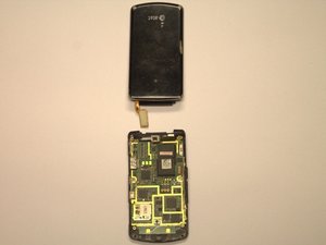

+[* black] Separate the top half of the clamshell from the bottom half by first locating the two hinges.
+[* black] Carefully pull to one side and immediately up. The top part should pop out of the hinge. Next slide the opposite direction to pull out of the other hinge.
+ [* icon_caution] ''This will take a lot of force, so be careful not to break the plastic hinge.''
