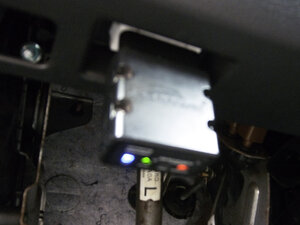

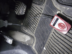

+[title] Clearing the Code
+[* black] Once the solenoid has been successfully replaced. Plug in your chosen OBDII tool into the port located below the steering column and slightly to the left. (''See photos''). Turn the key to accessory and use your tool to clear the code!
+[* black] Once you have cleared the code, start the engine to make sure the new part is good. Turn off your engine.
