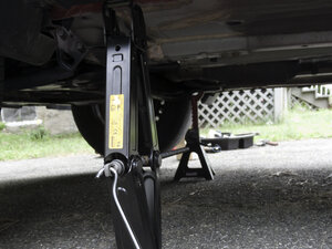

+[* black] Jack up the front of the car and support it on a pair of axle stands. There are no obvious axle stand points. Find a couple of structurally sound points to place the stands. I'd put chocks under the back of the rear wheels. When I parked, I placed the car in Neutral to ensure it was on level ground. Once on the stands, put the parking brake on!
