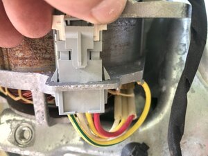

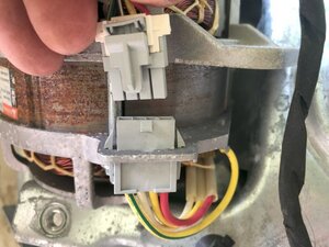

+[* black] lift the locking tab with your fingernail (or a small screwdriver will work as well )
+[* black] pull on the connector, (not the wire!)
+[* black] until the connector comes free
