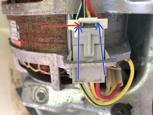

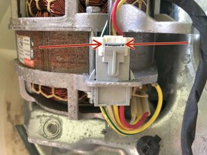

+[* black] and then lift it up. There is enough length of the electrical cable to allow for this movement.
+[* red] Next is to remove the wire connector. It does use a locking tab.
+[* blue] Move the locking tab up (you will now see the gap (Red arrow)
