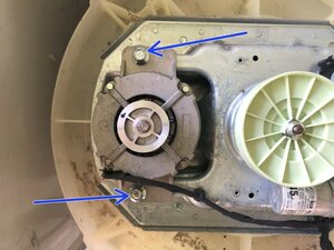

+[* black] Belt is now removed
+[* blue] The motor is held to the housing by two 13mm machine bolts

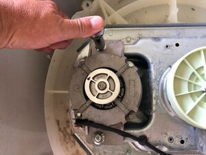

+[* black] I am using a 13mm socket to remove one,
