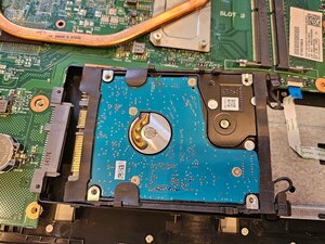

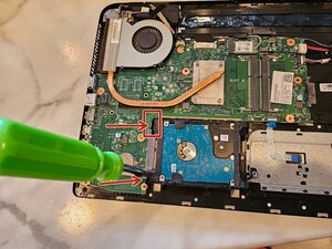

+[title] Remove drive
+[* black] Carefully lift up a rubber blocks; the rubber may be old and where it attaches is thinner. This will give you room to slide the drive.
+[* black] Insert a flathead screwdriver in the gap and slide the drive away from the connector. Do this on both sides.
