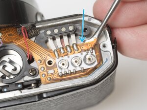

+ | [title] Unsolder wires under bottom plate |
+ | [* red] Unsolder one red wire. |
+ | [* orange] Unsolder one light blue wire. |
+ | [* yellow] Unsolder one orange wire. |
+ | [* green] Unsolder one purple wire. |
+ | [* light_blue] Use isopropyl alcohol to soften the adhesive under the flex PCB. |
+ | [* light_blue] Gently lift the flex PCB off of the camera chassis until it is free. |
