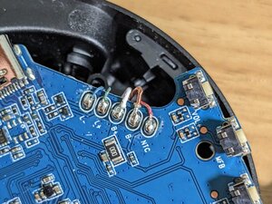

+[title] Re-seat the ear cup holder onto the earcup and re-solder the cable
+[* black] Re-seat the ear cup holder onto the earcup, making sure you pass the cable through.
+[* black] Re-solder the cables in place, making sure you keep the original order.
+[* black] Once done, re-add the screw, as well as the led cover.
