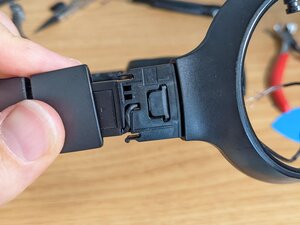

+[title] Reattach the hinge
+[* black] Align the new earpiece cup holder with the hole from before and re-insert the holding bar we pried out.
+[* black] Note: use a lamp to make sure you are aligned before re-adding the bar.
+[* black] Put the cable all the way as well. It is stuck in the headband by sharp turns so you do not need to be careful about pulling too much.
+[* black] The ear cup holder should sit nice and snuggly as well as swing as a brand new piece.
