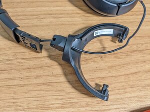

+[title] Slide the new earpiece holder in place
+[* black] We can now start to reassemble the replacement piece.
+[* black] Slide the new earpiece holder over the cable, making sure you do not kink or break the small wires that compose it.

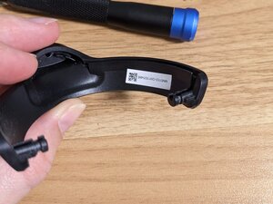

+[* black] Note: If you want to keep the older sticker from manufacturing, now is a good time to transfer it. You can soften the glue with some isopropanol and stick it to the new piece.
