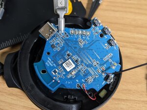

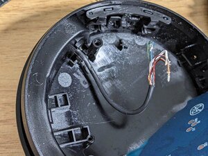

+[title] Unsolder the power and data cable
+[* black] Now that the board is movable (you can pray it a bit using the spatula tool in the I fix it kit), warm up your soldering iron as you will have to de-solder all 5 power and data cables.
+[* black] Be careful not to detach the microphone that is held in place with glue when moving the board.
+[* black] Once done, you should be able to lift the board entirely (careful with the microphone).
