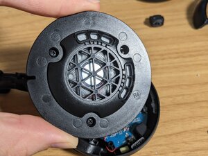

+[* black] The earpiece has 3 screws holding it to the back of it. Use your screwdriver to remove them all. The top of the earpiece should lift from the bottom piece.
+[* black] Be careful while lifting as depending on the side you are working on as there are cables connecting the speaker.
