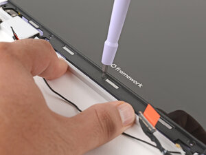

+[title] Slide the display down
+[* black] Use your fingers to hold the bottom edge of the Top Cover in place.
+[* black] Insert the bit end of your Framework Screwdriver into the small hole on the display, below the Framework logo.
+[* black] Slide the display down towards the hinge edge to release the tabs holding the top edge of the display in place.
