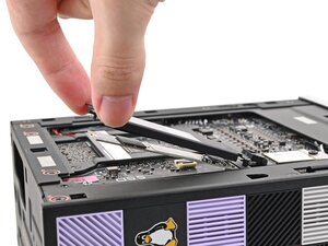

+[title] Install the SSD
+[* icon_caution] Hold the SSD by its edges. Don't touch the gold contacts with your fingers. If you do, wipe the contacts with a clean, lint-free cloth to remove any finger oils.
+[* black] While holding the SSD cover upright, align the SSD's gold contacts with its socket.
+[* black] Insert the SSD into the socket at a shallow angle. The gold contacts should mostly be covered by the socket.
+ [* icon_note] The SSD fits into the socket in one orientation. If it doesn't feel like it fits, try flipping the module.
+[* black] Lay the cover back onto the SSD.
