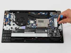

+[* red] Remove the five 5mm PH1 screws holding down the battery using the Philips head screwdriver.
