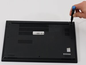

+[* icon_caution] If your device is swollen, bulging, overheating, or smoking, discontinue use immediately and DO NOT try and power on. It should be replaced immediately. Be sure to dispose of your swollen battery properly.
+[* red] Remove the eight 5.0mm PH1 screws on the back panel using the Philips head screwdriver. These screws stay seated within the back panel so do not try to remove them.
