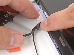

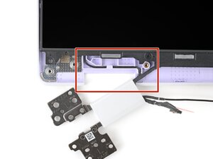

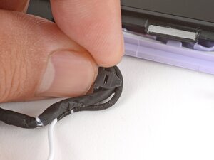

+[title] Install the hinges
+[* black] Place the cable clip around the left hinge cables, where they were bent from being inserted into the hinge.
+[* black] Use your fingers to press the clip into the hinge to secure the cables.
+[* red] Make sure the cables are properly routed in the Top Cover.
