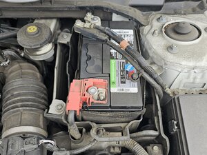

+[* black] Optional: rub the terminals of the new battery with some sandpaper in order to remove the layer of oxidation and provide better contact with the battery.
+[* black] Place the battery with the negative on the far side of you and the positive side closer to you (The indicators will be on the top of the battery right by the terminal)

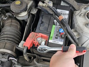

+[* black] Slide the negative (black) cable onto the negative terminal and tighten the nut
+[* black] Now slide the positive (red) cable onto the positive terminal and tighten the nut
