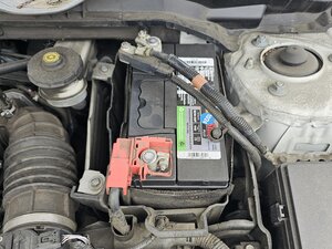

+[* black] On the right side you should see a battery with a red and black plastic covering on the terminals

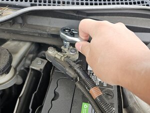

+[* black] With the 10mm socket loosen the nut on the negative (black) terminal
+[* black] It is important to remove the negative first in order to minimize short circuiting the battery
