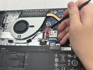

+[* red] Locate the antenna wires connected to the wifi card
+[* black] Carefully disconnect the antenna wires using tweezers
