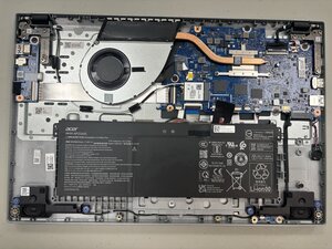

+[* red] Locate and undo the ten Phillips #1 screws holding the back panel
+[* black] Use spudger to pry the back panel from the chassis
