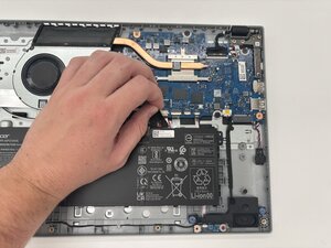

+[* black] Locate where the battery connects to the motherboard and lift the securing tape.
+[* black] Now carefully remove the wired connector from the motherboard.
+[* black] Lift the battery upwards to remove fully from the device
+ [* icon_note] There are no fasteners holding the battery in place only friction.
