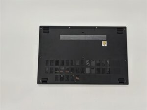

+[* black] Completely power off the device.
+[* black] Then undo all 10 mounting screws for the back panel Using a Phillips 1 screwdriver.
+ [* icon_note] All screws fastening the bottom of the device are the same.
+[* black] Now carefully pry the back panel and remove it from the chassis.
