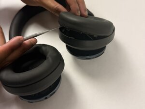

+[* black] Take a spudger and carefully insert it into the lining between the ear pad and the back ear piece
+[* icon_caution] If you're using a metal spudger (like the one pictured), it can cut you if not used correctly. Please be mindful of where you insert it
+[* black] In a circular path, disconnect the ear pad from the lining on the back ear piece
