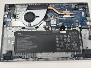

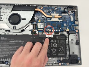

+[* red] Locate the connection from the battery to the motherboard
+[* icon_note] Connection may be under tape, if necessary lift tape to find connection
+[* black] Disconnect the battery from the motherboard
