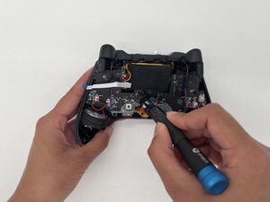

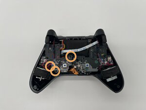

+[* black] Using the ***Phillips 1*** screwdriver, unscrew the ***three 8 millimeter*** screws holding the left side control panel.
