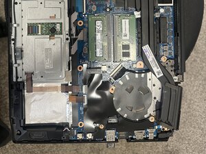

+[title] Remove fan
+[* black] At this point, the old fan can be removed. Note the cable running over one of the fan mounting locations. Take care not to catch this cable during the removal of the fan. Slide the bracket arm under the cable and remove the fan.
