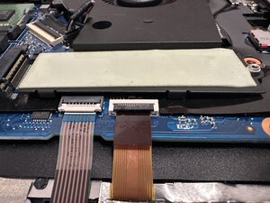

+[title] Transfer thermal pad to new fan
+[* black] This fan will include a place for the SSD's thermal pad. If your pad is in good shape, carefully transfer it to a new fan. If the pad is damaged, it must be replaced. The OEM pad should be sticky on the back to hold it on the new fan.
