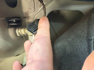

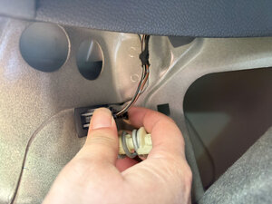

+[* black] Pull the power cable from the rear light assembly.
+[* black] Note: Some models may have small tabs on the left and right side of the power cable that need to be squeezed and pulled in order to disconnect the rear light assembly
