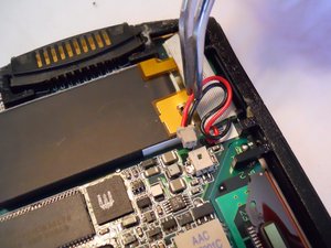

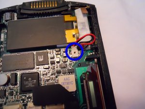

+[* black] Before removing the screen you must detach one more wire, the battery connector.
+[* black] Using the tweezers, squeeze the connector attached to the wire and genlty pull.
+[* icon_caution] Do not pull from the wire.
