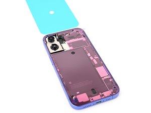

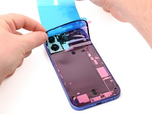

+[* black] Apply the adhesive up the sides of the iPhone, peeling the blue liner as you go.
+[* black] If your adhesive isn't perfectly straight, pull the long edges into alignment with the frame.
+[* black] Ensure that the top edge notches are aligned with the frame, then slowly lay the top edge of the adhesive onto the frame and roll the blue liner completely off.
