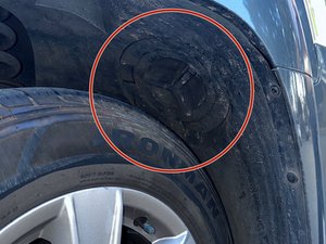

+[* black] Turn the wheels toward the opposite side of the broken headlight.
+[* black] Go to the Front fender that is on the same side of the broken headlight and locate the cover in the inner fender.
