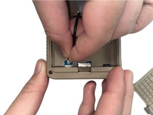

+[* black] A cord should still be connecting the battery and the system.
+[* black] Place your thumb and your index finger gently to the base of the wire that’s closest to system and pull softly and horizontally away from the small plug on the flat system.
+[* black] If done correctly, the battery should be removed without damaging the system
