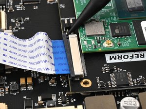

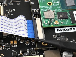

+[* black] Use a spudger to push on alternating sides of the locking tab that holds the ribbon cable in place on the processor module until the locking tab clicks into its open position.
